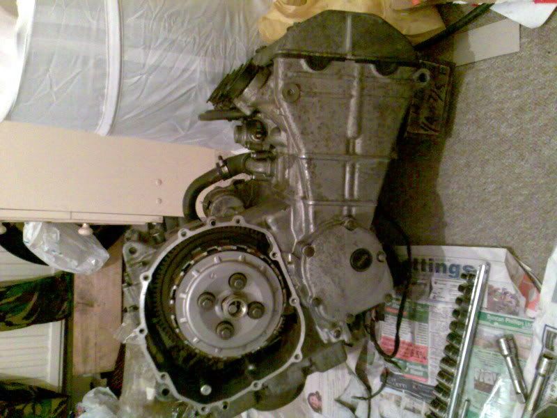

Recently i have been working on the engine, now ive got the new timing chain on and everything back together for the engine.
That was pretty harsh to put the engine back on the bike by my self without using anything. I will never do that again....
Anyway, the engine is now back on the bike and just need to do wiring, which im not really sure how to....

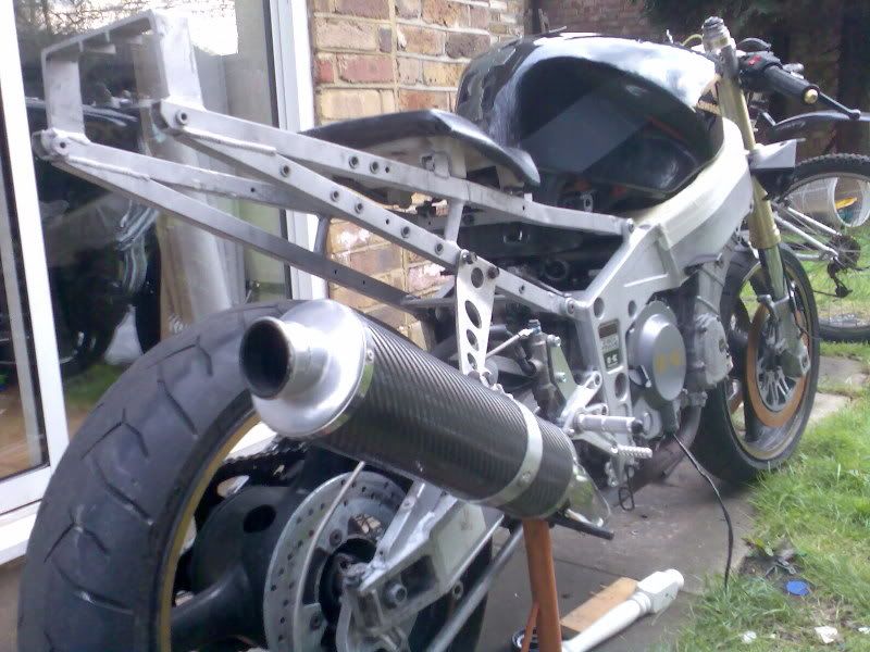

Once i got the engine on the bike, it really pushed me to give the bike a little bit extra treatments though....
First, i gave her new lightweight carbon ass as her ass doesnt sound nice when she farts..
Secondly, i bought her new 'legs' for me to put my foot on...

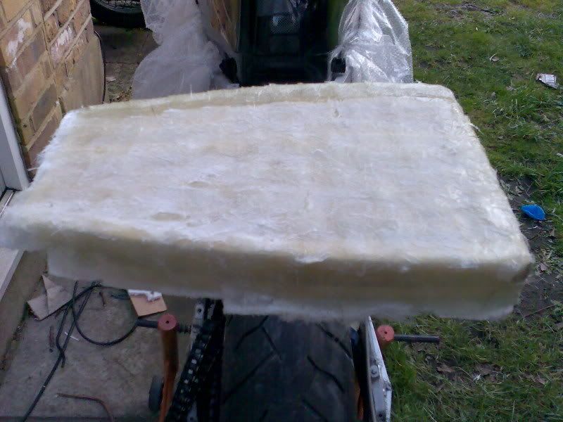

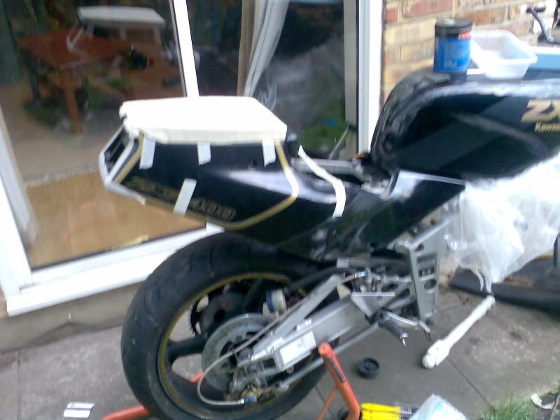

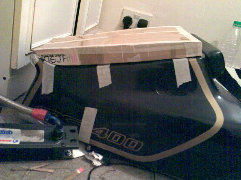

In my spare time, i also been trying to make a single seat cover from fiberglass. I hope this gonna work, i made the mold from cardboard and smir it with grease so the fiberglass wont stick onto the mold.
Well here is whats come up...

Some cracking work there, i like how you are doing all the fibreglass'ing etc.

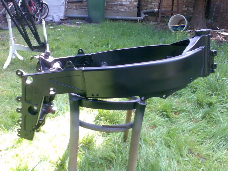

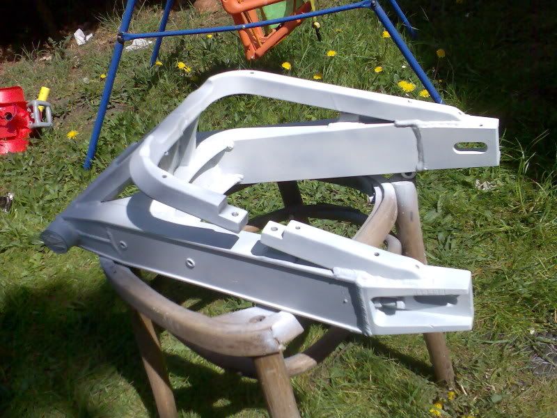

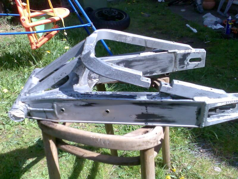

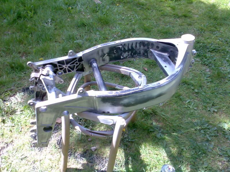

Over the weekend i was trying to finish up the bottom Ram air box and i actually had it finished. When i was doing the bottom ram air i covered the frame with masking tape to avoid any resin to stick on it. Cos i left the bike outside, the masking tape gets wet and when i took them off, the paint sticks on the tape and ruined the frame. Really was a nightmare that day.....
So i thought this would be the best to repaint the frame as the paint is peeled off in some places. Then i sanded down the paint on the frame and on the swing arm on that day....
And the next day (sunday) i took everything apart, get them all washed and smoothed up, and finally sprayed them with primer...
After 2 hours, the primer is dried. Next, i sprayed them with matt black colour. Then finished with laquer.
They came up nice, very happy with the result.

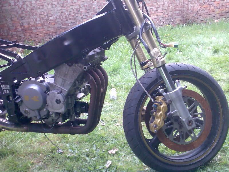

The next day (monday), I put everything back together and finally the calipers arrived.I Put them on straight away on the bike. Fits perfectly, no modifications needed, only need couple washers as the spacer. Woohooooo......Loving that look....
Finally i have front brakes, just need to clean off the front discs as they just rusty. And thatd be it for the brakes.

Mate, that looks phenomenal!!! The 6 pots really make the front end look good. What paint did you use on the frame?
